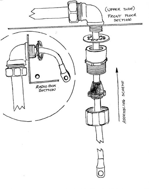

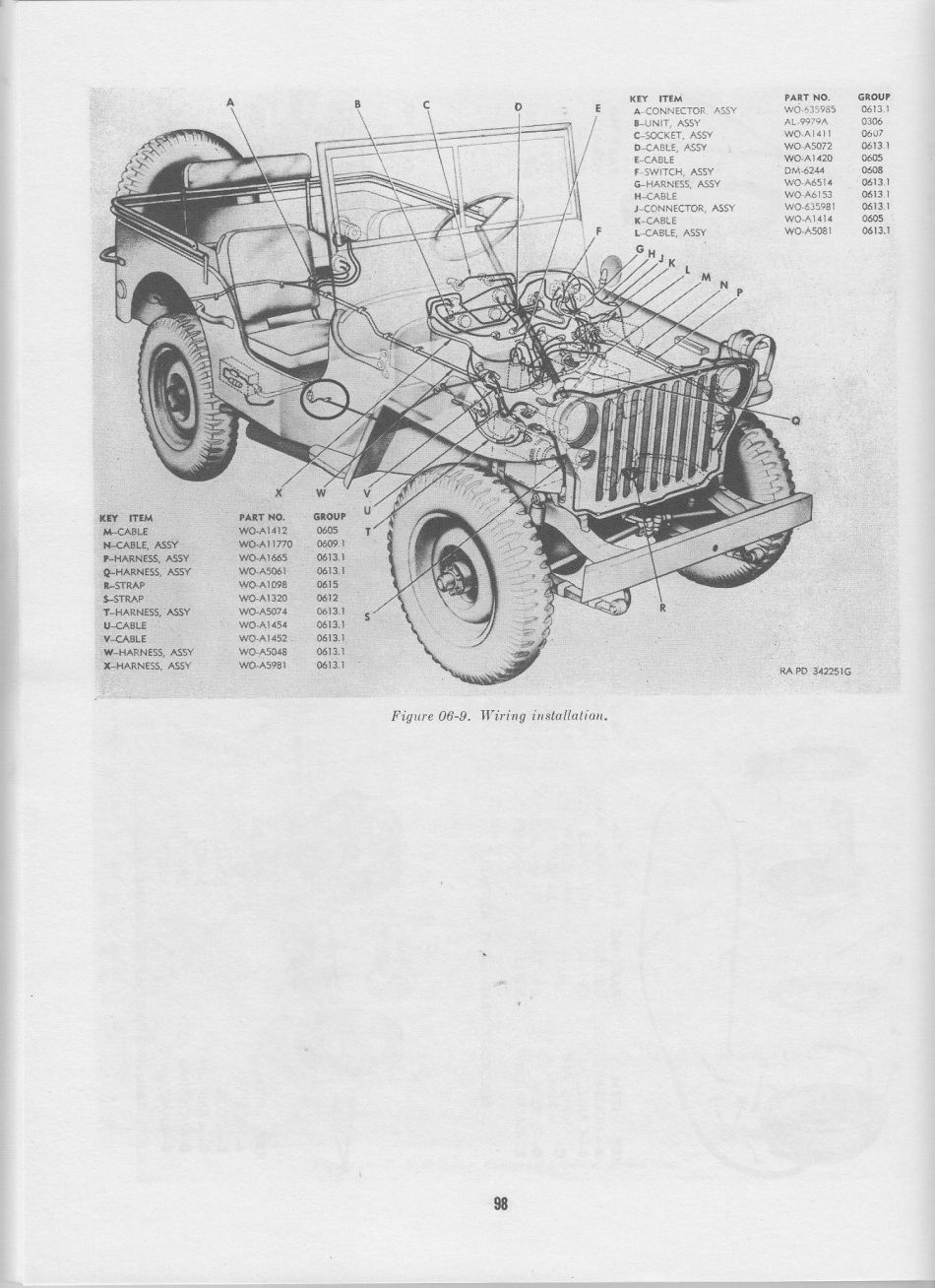

Notapor m606paz » 23 Ago 2010, 07:29
Aqui podran ver el recorrido del cable que llega al Control Box , que viene desde el boton de arranque en el piso.

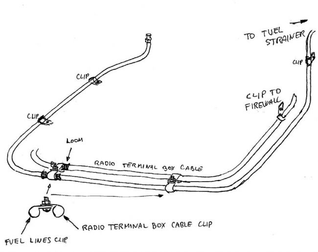

Notapor m606paz » 26 Ago 2010, 20:32
Y aqui más fotografias!!
Peewee escribió:Hello John,
thank you for the info, you are correct.
Paolo Batisti from Italy http://www.thelongolivedrabline.com/ sent me some additonal infos and drawings.
Three od semigloss clips where used to fix the cable.
One clip is atached to the fire wall on the follwowing locations:
Ford and Willys ACMI bodys TypI suppression at one filterette screw/nut.
STD bodys and Typ II suppression slotted round head machine screw n.10 to firewall captive nut, same location as the speedo cable clip.
The other two clips are attached to the fuel line.
One clip to the front cross sill with a slottet binding head sheet metal screw together with the clip that hold the fule line in place.
One clip is direct attached clip to clip, hold by a round head machine screw n. 10, lockwasher and nut.
Peewee escribió:This is the way how I attached my radio junction box and cable willys MB # 280611 DOD 12.Nov 1943 ACMI body, typ I suppression:
But I have to change the color of the clips, to semi gloss od. :wink:

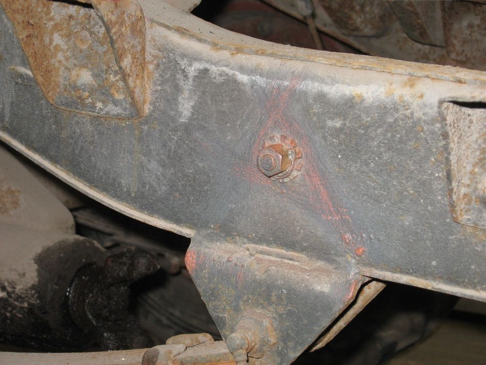

Notapor m606paz » 31 Dic 2011, 21:20
Aqui se ve como se conecta la masa del radio terminal box
En mi chasis, me encontre con la tuerca y la arandela este strap
Revizaron sus chasis a ver si tienen esta conexxion?? :roll:

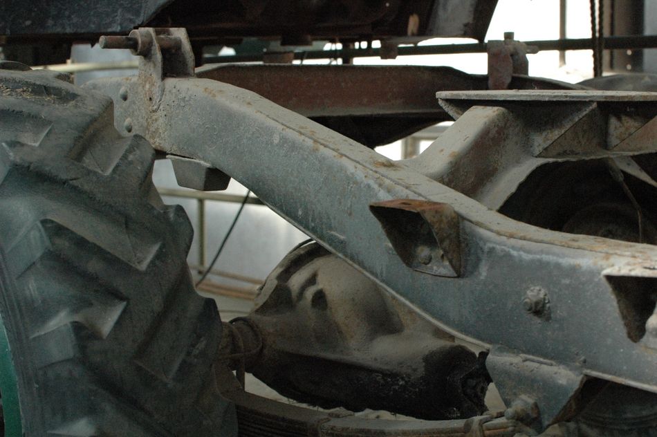

Notapor vladimirsinisi » 30 Abr 2012, 13:18
revisando mi chasis me encontre que solo esta el agujero exactamente en el mismo lugar, eso corresponderia a ese bond strap¿?
Notapor piyu » 30 Abr 2012, 13:48
El mio tiene el mismo agujero en ese lugar, vendria antes del 43 con ese agujero ?
