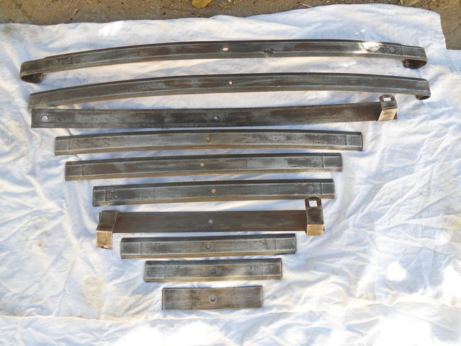

Dushy escribió:WILLYS MB 10 LEAF SPRINGS
Please see the pictures below of the 10 Leaf Spring that i purchased to use in replacing the damaged springs of my 8 Leaf Willys MB springs.
I have dismantled the 10 Leaf Spring to clean, remove rust and paitn with a primer etc
1. The Will spring Bands are clearly visible
2. All leaves are bevelled
3. Leaf ends are stright and not tapered
4. Spring Centre Bolt seems to be in bad shape.
I would be grateful for your valuable and expert comments
Cheers
Dushy
Ayer Pascual me comentaba que no es dificil viselar las hojas, si un laburo de monos. En mi caso ninguna de las hojas maestras es original y solo dos de las envolventes...
