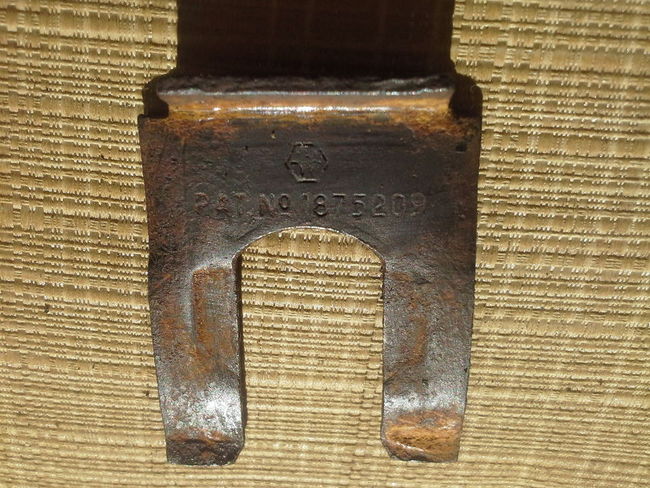

no , fijate que tiene un estampado redondo eso debe calsar en la punta del flexible !!!

la posición correcta es al revés de como figura en la foto !

Gracias Pascual por el detalle! mañana lo pondré como corresponde :wink:

aca encontre la marca de estos clips que segun Ben Dover son los originales:
Postby Ben Dover » Thu Jun 10, 2010 9:08 pm
Those nice spring steel clips used to secure the brake hoses to the chassis and Brake Hose Guard on Front Axles of MB/GPW thru M-38A1 and the CJ's were made by Weatherhead who was the OEM supplier to Willys.
After 70 years, they have finally been discontinued and none exist at the factory warehouse. The Logo, a ""W" stamped inside a Hexagon was visible on the originals, Weatherhead discontinued the Logo about 3 years ago.
There are other brands that will work, but none look the same as the originals.
vladimirsinisi escribió:Hola muchachos hoy le puse las trabitas de los flexibles de freno, son originales y estan en muy buen estado mirenel numerode patente y el logo.
